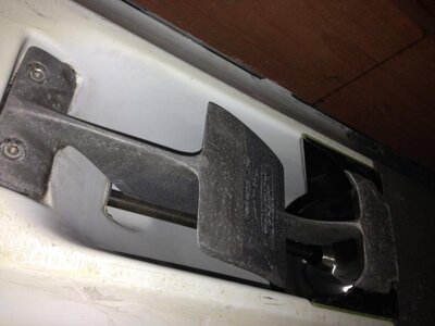

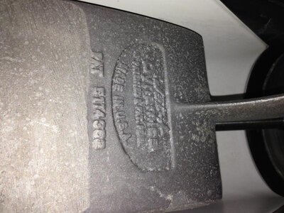

My 01 RN handles sketchy when riding in a straight line, intermitantly it tries to throw you off over the side. It seems like its catching the water somewhere about the center of boat then wants to toss you if you don't slow down. I looked at the intake grate and found its a jet dynamics deep top loader, at the pump shoe it hangs down lower by maybe a 1/4 inch and scoops water their too, I'am wondering if this is the cause. My works 201 on my other ski doesn't have that extra scoop at rear and hang down like that and it handles fine. The plan is to try another grate and water test. This RN has extended plat, destroyers, hooker 11/17 or 13/17 I forget which, blowsion steering plate, 701, b-pipe ect. Any help would be appreciated edit: this is happening at slow speeds 15 or 20, less than half throtle
