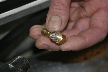

This came out of a Factory B Pipe after it's first time out on the lake.
