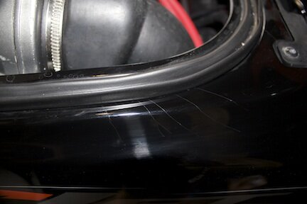

While i was cleaning the ski today i noticed these cracks near the hood seal. I havent done anything crazy on it other than one unsuccessful attempt at a barrel roll about a month ago, and those cracks didnt show up until after another 5 outings. the hood is definitely cracked which makes me worry even more. do you think they are just in the gel coat or does a crack usually only show up if its through the fiberglass as well? its on the engine side and i cant seem to see underneath to get an idea of whether they are all the way through. do you think this is going to spread? i know skis break but this is its first year.... i was hoping to keep it nice at least for the first season...
thats where it starts and thats where it will blow out if you incomplete barrel roll to the right. thats where i blew my red superjet out in one weekend after switching from my sxr. needs to be re-inforced if you want it to last.
