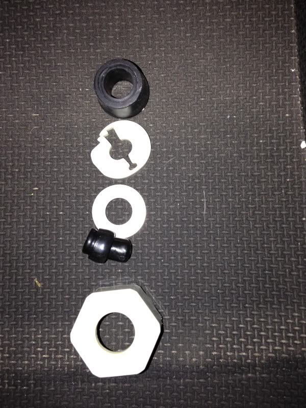

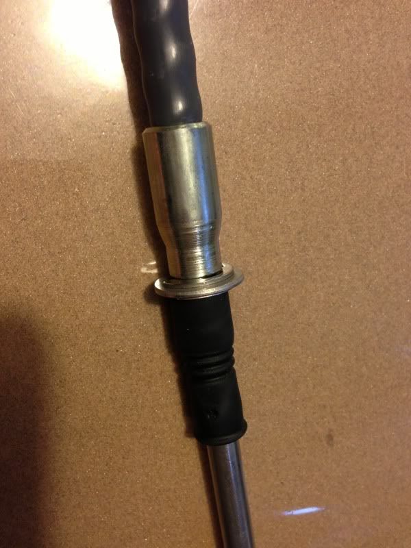

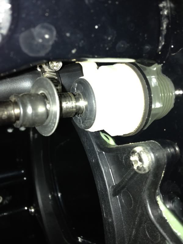

Will I reuse the white clip in the second picture? I have it already removed in the first picture. If I was to reuse the white clip it would go in place of the C clips and washer shown in the third picture of the new cable.
Do not reuse the white clip. Put it together with his c clip the way the pdf shows that I sent you. If you use the white clip and to not put the rubber plug like the drawing shows the throw/steering at the pump will be so out of alignment that you will not be able to adjust it out.
