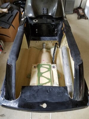

Working inside my Superjet tray after defoam and I want to get everything before I close it. Read tons of build threads but can't find a definitive answer on these:
Sealing cooling/trim lines from inside of tray - glass or 5200?
Sealing cooling/trim lines from outside of tray (engine bay) - same question
Green stuff Yamaha uses to seal - anything needed in these areas?
Drive shaft tube (where it meets the bulkhead and the pump tunnel) - seal with glass or 5200?
Lastly, holes on top of pump tunnel - how to seal Those?
Thanks for any help.

I would go with 5200 for everything inside and out. Glass the holes with epoxy on the pump tunnel
And 5200 comes two ways,7 days to get hard or 24 hours.Use the 24 hour 5200 unless you have time
