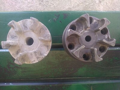

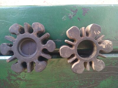

In the photos you can see some slight differences in the way the couplers are made , but it looks to me that the 650-750 style driveshaft coupler can be modified to fit the 951 dampener , the couplers are also very close in diameter , with a minimal amount of lathe work the two will become the same diameter. I have a buddy that has a lathe I can probably get some time on.
I am modifying the leg on the 650 coupler with a die grinder to be straight like on the Seadoo coupler, I will also have to slightly enlarge the rounded part of the coupler , I am using a socket that fits the profile on the Seadoo coupler as a gauge on the Kawi coupler. The Kawi coupler is on the left the Seadoo is on the right , the dampeners are in the same order.

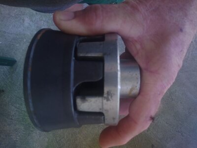

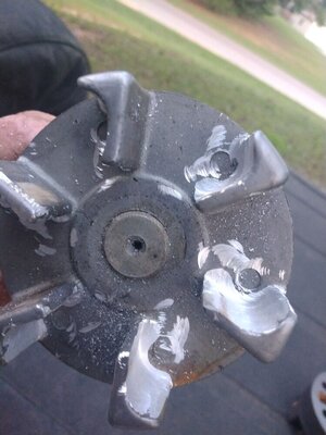

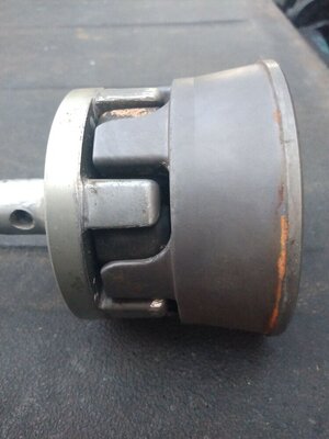

The two now are mated in an unholy union and it looks like it will work quite well, I am not totally happy with the machining on this one but I know what to do better next time and I figured I would mess up a few before getting it like I want it.
On the next one I will cut less and finish more of it with a sanding drum on the die grinder for a better fit and finish , I am sure this would work just like it is but it never costs any more to go first class.
There is plenty of meat on the Seadoo coupler to get it to the correct diameter as well as cut down the length a bit for better fitment .
