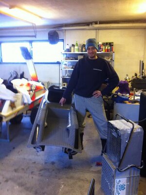

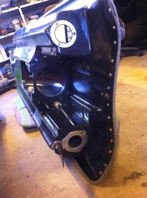

So the freightman came by and dropped to babies off for me :)
First a full visual carbon Lenzi SJ style -3" hull, this thing i stupid light. 21kg! 46 pound, without hood. with pumpshoe and steering cable. And some reinforcement (carbon kevlar) This is gonna have my new DASA 850 SS engine, with MSD dual ch digi TL, dasa / vforce intake. And for carb im not sure yet, but something between dual OEM 46 and dual 49 FS :) Pipe is going to be PFP. Last but not least a 144 mag.

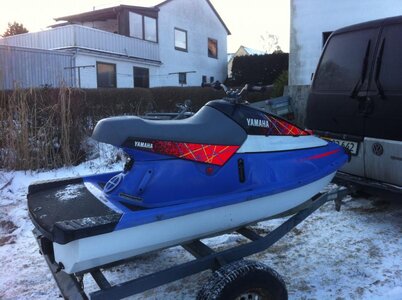

Second is a Blaster 1. missing the exhaust otherwise complete. :)
In Denmark the jetski sport is pretty limited yet, but growing in a stedy paste. I havent ridden a B1, but got this blaster for "steal" so im pretty stoked!

Has anyone ridden or built one of these Lenzi hulls?

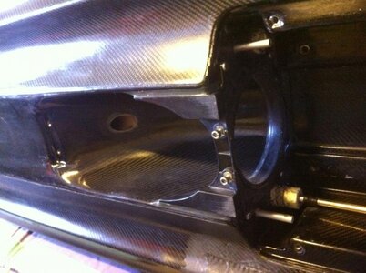

Just shot a few more pics, forget pics of the hood, i bought a used ATP prepreg carbon hood, this thing i stupid light allso! I weighed everything on a bathscale, wich claims to do .1kg (100grams) interval. weiged a stock hood, 7.1 kg, WDK razor hood (surf) 7.1 kg and the ATP hood couldnt show any numbers, i started puting things on it to get a reading, it started at 4 kg. Im guesing the hood is between 2-3kg. very light and nice quality! and the hull, with some carbon/kevlar reinforcement, pumpshoe, turf and HD steering cable, scuppers and exhaust tube showed 23.4 kg :)
I noticed just before the intake duct, the bottom hull carves down. allso the whole driveline is setback compared to a stock SJ
