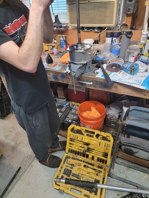

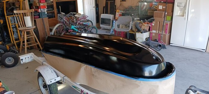

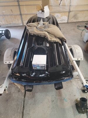

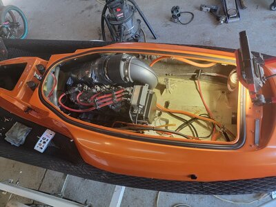

Posting some pics of my current project, hoping it will be done by the beginning of summer, all I need now is the exhaust conversion from Rad Dudes, and to get this trim kit figured out.

Basically, the tab that comes off the steering ring that controls the trim hits the hull, forcing the pump up about 3/4 of an inch. If I were to rotate it, I'd have to find a way to make a cantilever to push when I pull the trim lever. Mostly just a clearance issue for the way they intended it to go in. Also, I want the trim to force my nose up, not down.
If I were to get a pump set back kit, the 2" it gives me wouldn't be enough to clear the back of the ski. I know these kits are usually for a rickter hull, but I was lead to believe it would work with the blaster too, but I don't see a way to do so.

For further reference, the back of my ski is stock, hasn't been modified, cut, or anything else that I am aware of, but may have gotten repaired at some point, can kind of see it in one of the pics of the back.. I got a solas 148mm mag pump, which sets in the same as the stock 144mm, so no dimensional issues should come from that.
