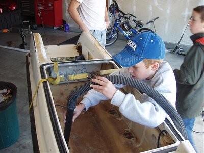

I like to have my kids disassemble and vacuum them out after every use.
New turf also.:biggthumpup:
