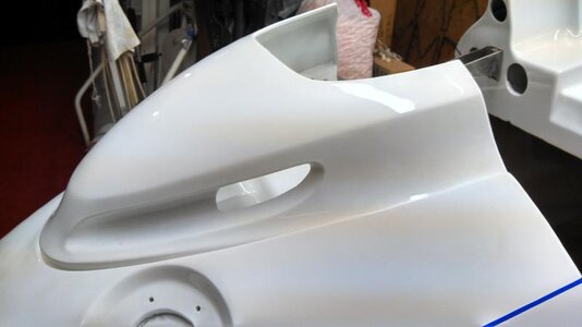

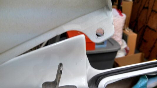

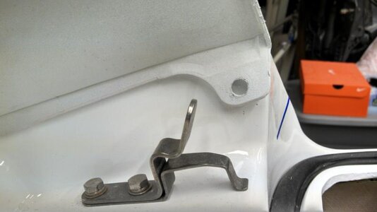

Looking for how the plastic front end piece attaches to the ski, it slides in under the front, and then I remember a screw goes on each side in the back, but wasn't there some kind of washer/spacer/compression something that went in there so as to not mash the plastic with the woodscrew ? Pics to come...
Took this thing apart too long ago, apparently I have lost a few parts in the process. Anyone have any they want to sell / donate ? Know where to find them ?
IMG_20130812_214141_339.jpgIMG_20130812_214151_955.jpgIMG_20130812_214133_866.jpgIMG_20130812_214141_339.jpgIMG_20130812_214151_955.jpgIMG_20130812_214133_866.jpg
There's supposed to be stainless steel collars and phillips head tapper screws. If someone glassed over the holes you can just redrill and put the tappers there. I'd shoot jetmaniac a PM, he seems to have surplus of OEM parts
