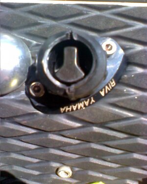

after breaking my rotary switch (again) last weekend, i put a new one on and didnt want to break the new one, so i came up with this. i think blowsion makes a protector, but this was free and i hate waiting for stuff.
its a riva duck-bill drain fitting. i had to grind the 6 corners of the plastic switch nut to let the fitting slide over it and 'squash' the turf a bit. i put the rubber from the bill over the fitting, but cut the bill off for a little cushion around it.
i hope it works good enough.

im not sure how it broke. i rode up to the beach and went to shut off my pumps and it was broken off.
mine looks to be way less of a shin buster as its bigger, rounder, doesnt protrude into the tray as much and has the rubber around it.
