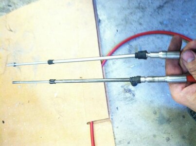

I don't know if this differs between mfg's, but the crimp is different between the two cables.
1996-2007 RN cable is on top, SN cable on the bottom. This is the pole side. This photo shows how the RN cable mounts differently because it is 'longer'.

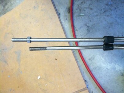

Same orientation, still the pole side. This shows the addtional throw found by using the RN cable.
