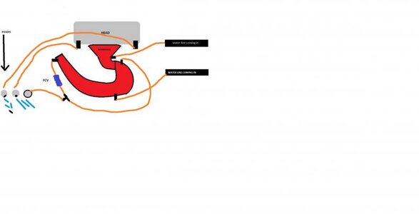

Super Jet Riva red dual cooling diagram
JT_Freeride
John Tetenes @Jtetenes
Long Island
Hey guys does anyone have a diagram on how to run the cooling lines with a riva pipe and ADA head. I was thinking running it similar to the b-pipe.
btmboards
Brett
Oceanside, Ca
Run it the same as a bpipe, heat is a good thing in the pipe and that setup won't let you build any heat at all. Too much water running through it and the motor to build any heat at all in either.
