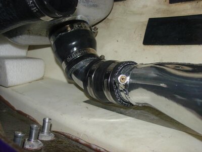

#ZERO
Beach Bum
Florida - U.S.A.
Glad to hear someone else got this to work too.
I'm using a 1.5mm restrictor at the stinger inlet and a 2mm restrictor after the T-fitting before the bypass.
The less water you have in the exhaust system will produce the most power but you have to worry about burning the rubber hoses up.
Also anything more then 3/4 to 1-turn on your head pipe screws will always have the same amount of water unless you make the hole size larger.
He's a picture were I tapped the stinger water inlet fitting to accept holley-weber carb air corrector jets and used silicone hoses.
