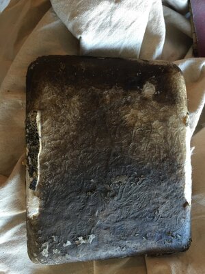

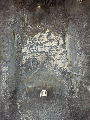

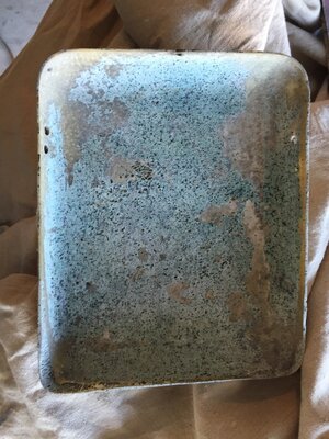

Ok, I emailed and texted hurricane, took about a week to get a text back saying just use hammer and chisel. Said pan probably not be salvageable and just to turf hull, no cradle needed for stock Sj tanks. So I went out and stuck a long screwdriver under pan and to my surprise pan came out with not too much effort. Just had to chisel some Resin/glue off and sand down. Pan is made of fiberglass, I thought it was aluminum the from the way it looked. Pan was only glued on each side where it contacted sides of hull. Pan still usable, think anyone would want it? Getting my ufo mounts from jet maniac Monday. Chris said epoxy resin would be fine and to put cloth around for more strength. Thanks for all you guys help!
