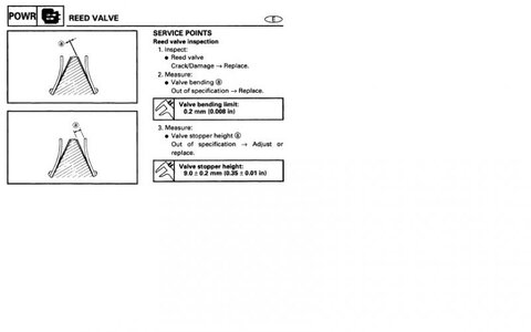

I've done some searching on this site and can't find an answer to this question. Is the valve stopper height measurement spec the same for 62T and 61X? My 61x reed stopper height is measuring about12mm. The stoppers seem pretty strong,do I bend them down a little or leave it? I have stock/metal reed pedals that are stillsitting tight to the cage. Attached is a print for the 62TReeds.jpg
