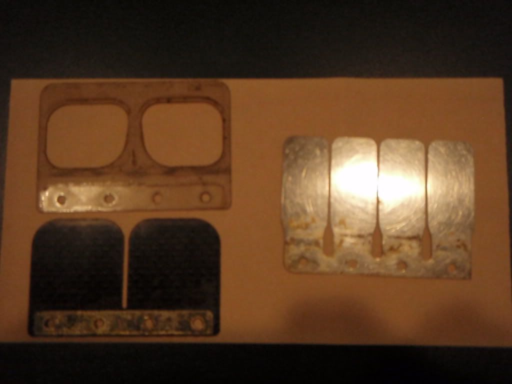

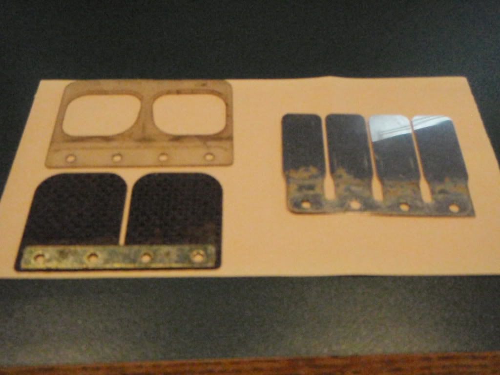

Are these metal reeds stock or aftermarket and are they any good?

The SS metal reeds are OEM Yamaha. They will work fine, but if one breaks and goes through your engine it could spell trouble. They are pretty old skool these days. I dont even know if they still make them for any Yamahas. They switched over to fiberglass some time ago.
If a fiber reed goes through your motor it will probably just get chewed up and spit out with no damage.
Definitely stay away fro the SS reeds.
