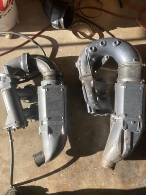

Verdict: it fits! Just barely though, with a lot of cutting. First up we have a comparison of the 701 [left side] vs 760 exhausts. You can see the 760 manifold is much nicer both outside and in with smooth bends not just a log. Also, the 760 stinger is quite different. Head pipes are different but it seems like its just external vs internal water cooling. Expansion chambers are the same part number. I went with the 760 exhaust.

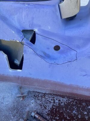

First step is to mock up and cut a small hole and see whats up.

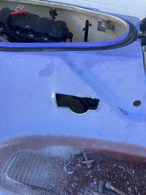

Then you keep cutting. I wanted to cut as little as possible at first, I will clean it up when its all finished and I'm ready to fiberglass everything.

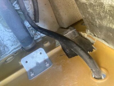

Last was cutting threw the bulkhead. What a pain! Its like 1-1.5" thick. Hole saw, sawzall, and dremel were all used.

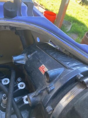

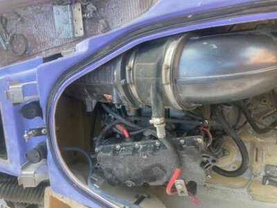

She finally fits!
