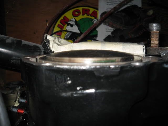

I threw in some stock domed pistons today to see how much they stick up. Overall the deck is 4mm when i compared it to a stock cylinder.When i measure the piston in the attached pictures (the Very lowest part of the domes) to the top of the cylinder it is 4mm. I just want to make sure this is correct? I dont know why i am so nervous about it, bret said it is suppose to be for R&Ds not kawis
They have different shaped domes also, if you use an R&D piston in a head with domes designed for Kawi pistons, you'll have an inverted squish...runs okay, but not the best idea.
