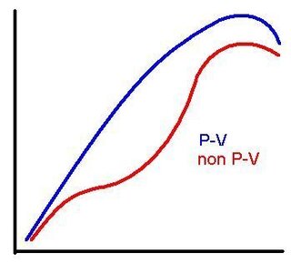

valves dont nessassaraly make more HP, but they allow you to make a motor with a bigger exhaust port and then vary the timming of that exhaust port, so in the real world you get more low end and more top end.

From what Paul has told me, the powervalve engines make more power, however, they are smoother.
I passed up a PV cylinder for my non-PV cylinder because I wanted the motor to 'hit'.
The nice thing is that the 3rd generation cylinder already has the boss' on them. So any time I want to add powervalves I can machine the slots and I'm good to go. I doubt I ever would because I really like the power delivery the way it is.

Dan Lamey said in an old post that they make the same power above 5500 RPM weather or not they have exhaust valves. I might be misquoting 5500 RPM but you get the idea. You should be able to adjust the tension on the valves to tune when they open.
I think the powervalves take out the "hit" because there is a smaller jump in power around 5500 RPM when the valves are there, because they increase the power in the lower RPM's to match the power coming on when the valves open. Did that make any sense? It should really hit harder with valves, since the horsepower is higher down low, but overall it will be a smoother powerband if tuned correctly. That's the way I see it anyway.
