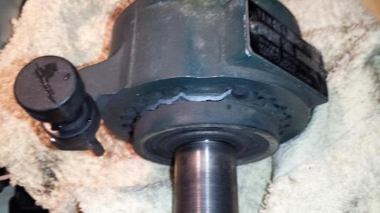

I put a newly built mag pumps in my ski and it ran great 10 hrs. then it suddenly starts cavitating
like there is a stick in the pump of it is sucking air somehow.
What would cause this?
Lost the pump seal or midshaft maybe?

pulled the ride plate, it was well sealed to the hull.
pump seal looks good all around.
guess I need to pull the motor to check the midshaft
tor*p*do
Squarenose FTW
NW NC
think it may be the midshaft.
completely separated. :crazy:
and its a 1990, so only 23 years old!
