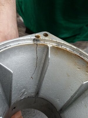

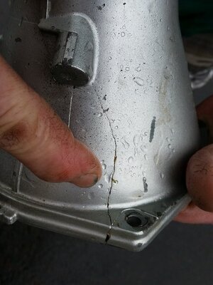

Looks like the dowel pin miss-alignment cracked it. My guess is you could still use it if you wanted to. Drill the end of the crack so it wont grow anymore, plug with JB.
