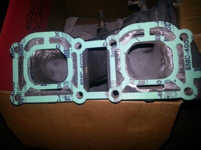

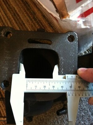

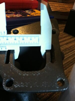

So I've already modified half of the exhaust to fit the 701 ports and was wondering if I should expand the water jacket ports as well?
I'm having too much fun with the dremel tool

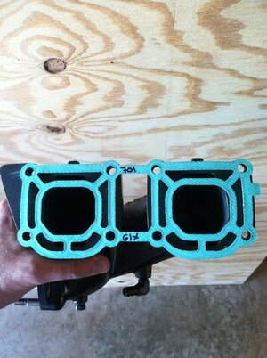

the gasket covers some of the port on the exhaust side. the engine side its completely open like the gasket. i think im going to widen it out a little bit at an angle and call it good. Anyone have a protect pipe for a 701 that they could take pictures of or measurements?

Are you trying to use a 650 gasket onto a 701 cylinder as well as a 650 manifold on to a 701 cylinder, if so match the gasket to the cylinder then set the gasket on the manifold, scribe and then widen as needed. Or just get a 701 gasket and use as reference
