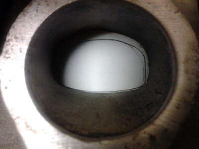

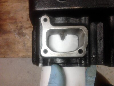

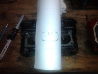

smothout and shape the pockets. use the guide to be sure you are not opening up the port at the cylinder wall yet.
these are pics with the pockets done before the ports are opened up.

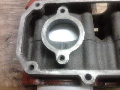

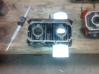

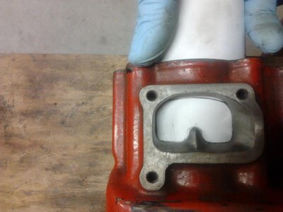

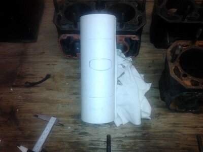

then widen the ports, lower the floor of the intake and raise the roof of the intake
these are pics of a mild port the ports are widened about 2 mm the intake is down about 1.5 mm and the exhaust is up about 2

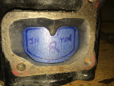

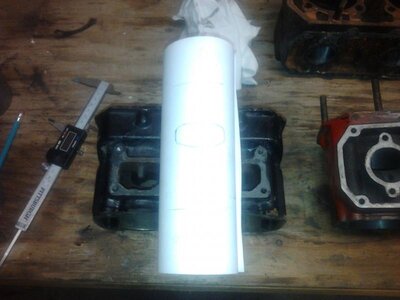

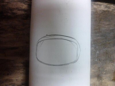

NOTE: the patterns in the above pics are a little rough cuz they were done just as an example.
here are a few more tips:
you can use spray paint to make your patterns too they will be a little clearer but you got to clean the paint out of the pockets when you are done.
use an old piston to hold the paper in tight in the cylinder when your making the patteren
if you make measuurments off the pattern it needs to be in the shape of the cylinder

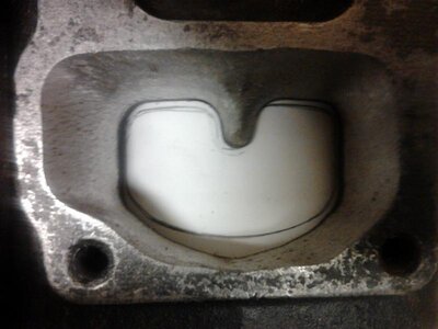

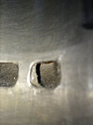

to best port the engine i would recommend using smaller 1/8 inch carbide bits to get into tight places in the cylinder.. such as the transfer ports.. i just did my reed cylinder with my dremel and bits like these.. http://www.ccspecialtytool.com/carbide-cutters-18 on the exhaust port, the idea is to get the ports as smooth as possible.. start with the carbide burr, then go to a grinding stone, then use a sandpaper roll on your dremel or die grinder.. then to get the final polish, wetsand the port starting with 220 grit, then 400, then 1000 grit... after wetsanding with 1000 grit the port will be very shiny so that carbon will not stick to the port... it should look something like this when youre done... again this is only the exhaust ports..
also a good rule of thumb on widening exhaust ports is not to exceed going more than 70% of the bore of the cylinder
expect to spend atleast 12-15 hours porting the entire cylinder haha i spend over 7 on my exhaust ports..

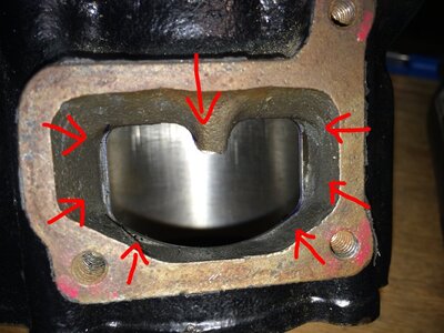

This is why you want to port and polish your cylinder!
^^ Stock 550^^
^^ Not so stock^^ :D

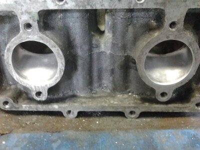

And don't forget the transfer ports!
Chances are that your stock transfer ports look similar to this.
