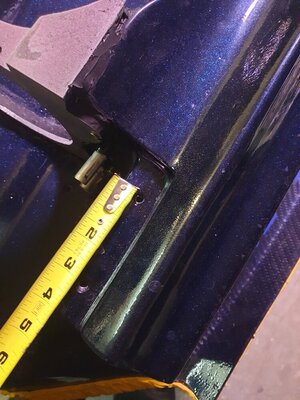

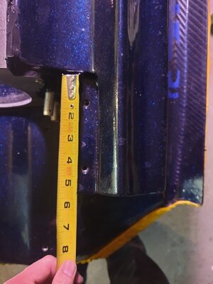

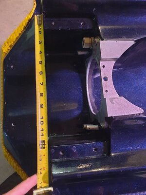

So I purchased a piranha carbon hull. I was told it was an RR hull which stands for ramp ready I have almost everything I need to start assembly the only issues I'm having is figuring out what pole bracket will fit and what ride plate. Its very similar to the Evo but I believe its a little shorter. Any one have any knowledge about these skis.
Ok so I figured out the pole attachment. I got the blowsion pole attachment to work. The ride plate is another story. Its 13.5 inches wide 5 and 1/4 inch long rails were the sides of the plate rides and bolts up and the bolt holes are 3 inches apart looks like a gp760 plate maybe a rickter but I think they are wider any ideas.
