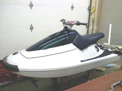

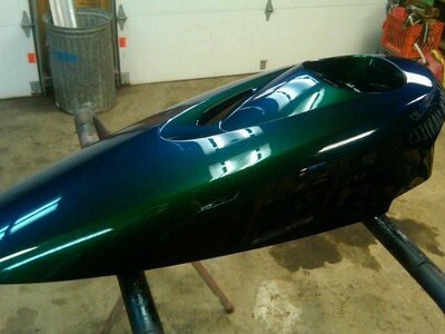

Check my build for paint refrance PPG & Deltron DC5100.
