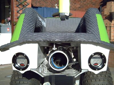

I put 2 x XFT monster 3" scuppers in and run a switchable 500GPH electric "because I can" :nana::nana:
Looks pretty sweet. Do they leak at all?
