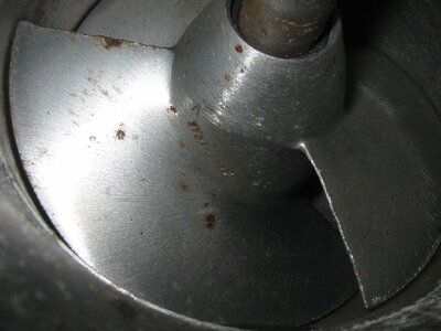

thats a variable pitch impeller. the actual pitch is probably stamped behind one of the blades.
check your clearance and bearings.
also, make sure that you leave absolutley NO gappage with the silicone when you re-install that puppy. sometimes its difficult to get your finger all the way up top in the pump cavity to spread the silicone because the drive shaft is in the way. if theres the slightest void in silicone, itll cavitate like a mofo.
