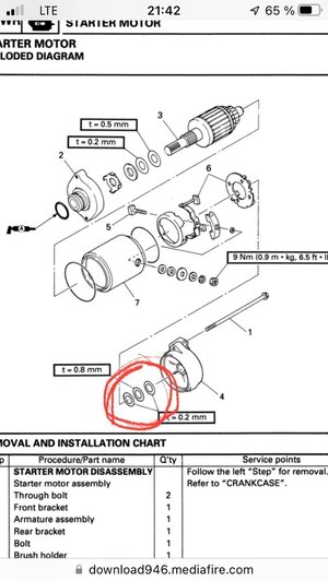

I want to rebuild a starter normally I don’t use new washers but at this starter I ordered the oem starter washer kit
But now I am confused because in this kit are 5 of the small washers for the backcover
The manual shows only 3 ones and also only 3 where installed
Somebody know why there are 5 of the small ones in the oem kit ?

I don’t know why…. I’ve also only found 3 in the back cover.. The service info shows 2 different sizes, I’d measure your 5 and verify there is only 2 sizes..
Then it Might have been packaging error or like on my job, I order 1 bolt, but a package of 5 comes in
