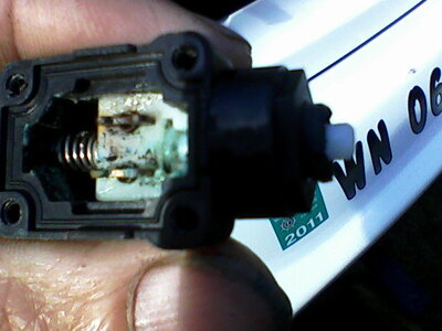

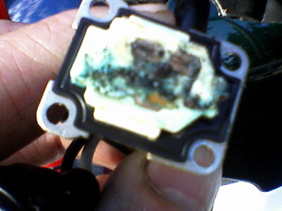

!cid__Photo-0098.jpg!cid__Photo-0097.jpgHad the opposite with the Blaster, it shorted out and would not fire. Turns out the rubber cap on the end was gone on the switch button.
John at JSS does away with the boot and puts a small stainless sleeve with an oring on the lanyard connection. I got 2 done 2 years ago and they have worked great. cost me like $65 each but better than spending money on a used one that may already be compromised.
