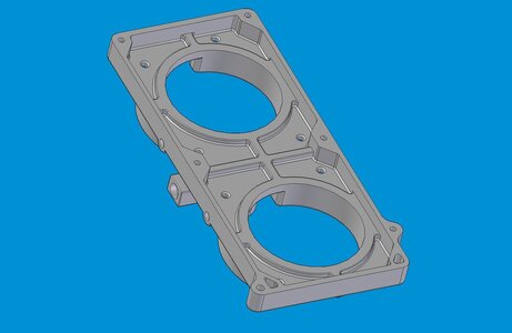

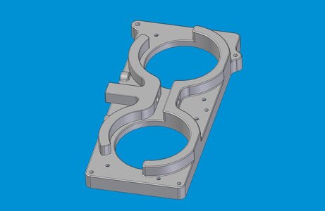

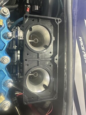

In 2004, I was involved in the development of a plate designed to be mounted on top of the carburetors, allowing the use of flame arrestor adapters. This setup proved effective with 38mm and 44mm carburetors; however, it caused the engine to run rich when 46mm carburetors were used.
This discrepancy might seem puzzling given that the area of two 46mm diameter carburetors (3322mm²) should be sufficient compared to the front of the OEM flame arrestor, which measures 80mm (5026mm²). The issue arises because the plate positions the adapter higher within the airbox, which impedes airflow.

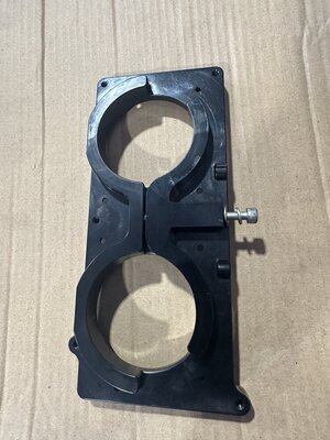

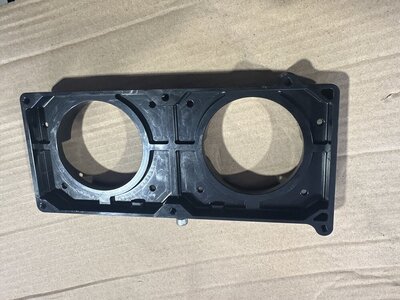

To address this, we developed a new bottom plate that draws air from the bottom of the OEM airbox as originally designed. However, adapting this solution to larger carburetors presented additional challenges. We explored various clamp devices, but the wide variability in adapter diameters made it difficult to achieve a secure fit. After considerable thought, we designed a separate clamp that applies pressure directly to the adapter without flexing the components.
Additionally, our adapter features a support mechanism that utilizes the fuel pump for added stability. Please refer to the accompanying images for details.
This is the initial version of our solution, and we are open to feedback on any additional features you would like to see.

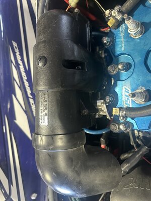

Awesome! I've seen another solution similar to this but used individual pods on each carb like the 61x ones. Have you noticed any difference in performance between 2 single arrestors and one big one like this? I had a 64x arrestor on my ski and ended up swapping for 2 61x arrestors mainly cause the 61x style are slightly lower profile for hood clearance

The issue i have with the single ones is they pull off the top of the engine which still get splash on it from the head. not bad but not perfect. you can turn the single one but then the back one is pulling from the back of the ski

Come to think of it I don't think I have ever seen a ski with that style flame arrestor come in with water ingestion issues.
