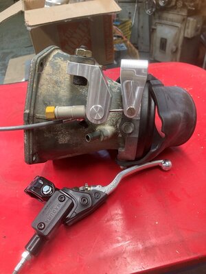

Thats pretty cool. Let us know how it works. It sucks buying trim cables maybe this will work better and be easier to pull.

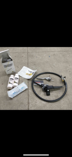

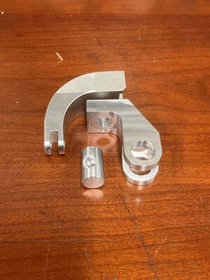

I’m gonna make a couple tweaks, and I’ll run another set of brackets for you, the clutch setup is for an 02 yz250, I think it was close to $200 on eBay, and then I bought a long an-3 line and adapters from kartech and I think that came to like $40 or so. Have to cut the stock trim ring down a little and drill a new hole

My guy you made my night! I already bought a Magura actually to try my hand at it but if you already have the brackets that would save me a good bit of time! Lmk
