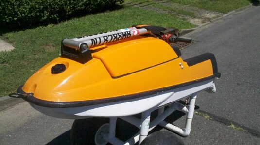

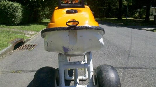

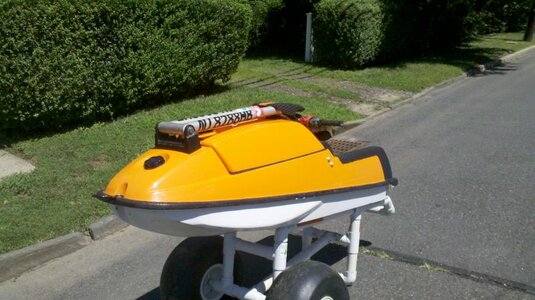

Well as alot of you seen it posted here on the x, this ski got finished on a coffee table on the 5th floor of the coral beach hotel in daytona this past year. It has been done since then, i spent all season so far beating the hell out of it, with little to no problems. So i feel its due its proper 15min of fame.
Fx1 kawi pump converted (poly foam 85 lbs hull), tubbies (for arguments sake well call them "blowsion style" made to fit an fx. 1/2 stainless cooling line. thruhull bilge drain. Footwells full length of the tray. (i cut my foot wells lower and with a more horizontal top, so i could lock in a bit) And of course it has to have an sj fuel tank.

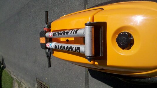

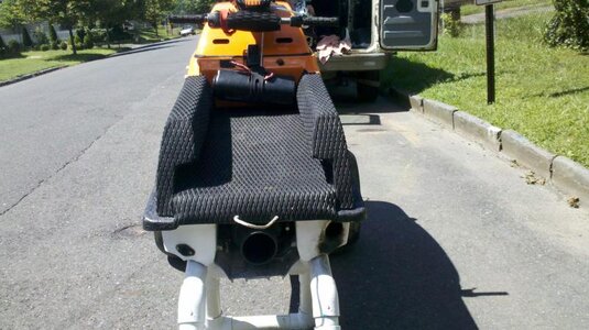

Pole i made (it is def a copy of a goose pole but much better) i used actual bolt and turn plate bushings not little plastic washers, as well as my own style steering stop/ chin pad holder.
