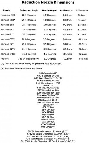

We were just talking about this tonight,how does the 62t nozzle with a 21 degree reduction compare to the 61x with the 25.5 deg in low end performance if both were at the same 82 mill bore
waternut,what size was the 62t taper bored nozzle,I just added a ww cone to a 10/16 hooker with a 85.5 nozzle on a decent powered 5 mill stroker and didnt see any big diff,it seems to make the pump vibrate more trying to stay loaded,may have been something else,not sure.
Phil ...pretty sure all the trim nozzles are 62t ,mine was.
#zero, Phil and I live pretty close and a few other guys in our crew need nozzles bored send me pm with a price for taper boring a group of them together.
lets talk sizes here,what are the best type nozzles to run for freeride and freestyle and what size bore for basic 5 mill strokers and big bores running hooker props? Seems like in the pump reference thread most guys are running 85 to 86 but x or t is not listed
