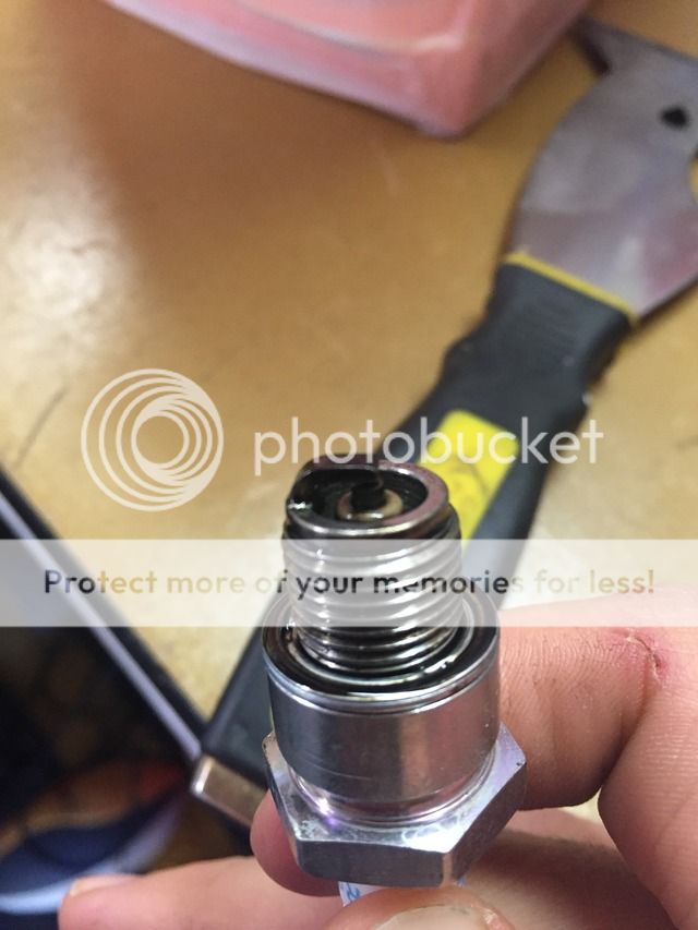

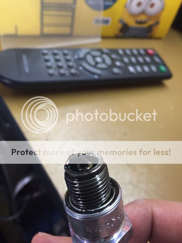

swapped in a 62T to replace my 650 in my SN. wouldn't fire at first unless I poured gas down the carbs. It runs fine until about half throttle--I copied and pasted below my post from another website--
It did fire when I poured gas down the carbs. it idles fine out of water. I dipped it in the river while on the trailer and it idles fine, 1/4 throttle fine, but half throttle is starts sputtering and full throttle it dies.
I ended up replacing the diaphragms with new ones since the old ones had crusty crap around the outsides. I cleaned the fuel filter and also blew out the jets.
I just dipped it back in the water today and it still has problems but they seemed to improve.
dipped in the water and it idles perfectly, 1/4 is great but half throttle is dips low in RPMs like its about to stall and full throttle does the same thing but after about 5 seconds of "low RPMs" it finally revs up. I only got to do it twice because it started slipping off the trailer lol.
any ideas what to do next? the 650 engine I had running in there ran perfectly so if it's a fuel related problem I think it has to do with the new 62T. it also has brand new spark plugs
