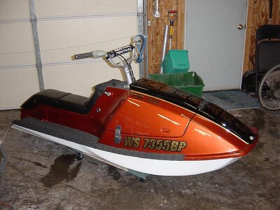

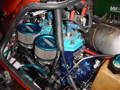

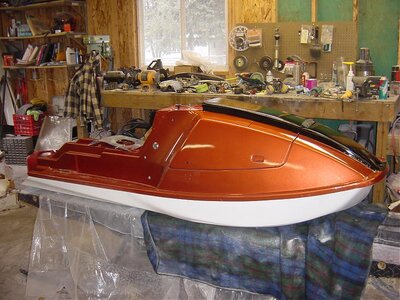

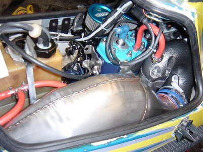

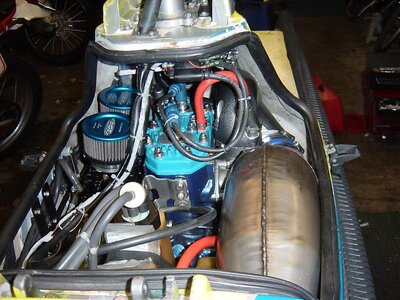

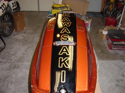

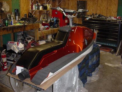

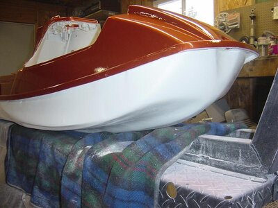

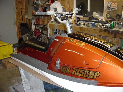

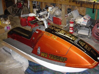

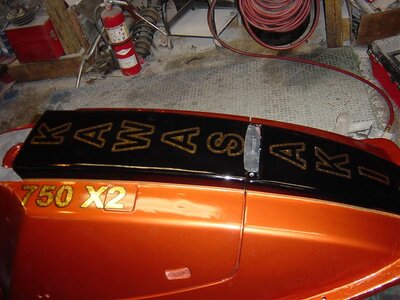

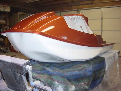

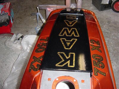

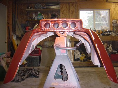

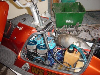

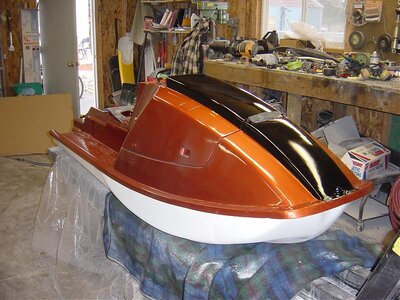

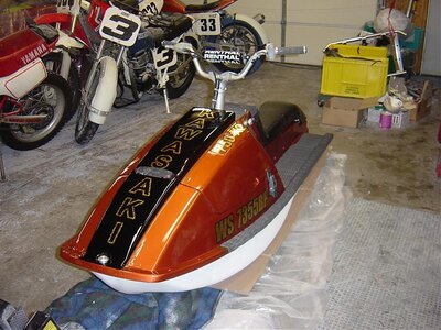

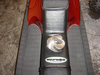

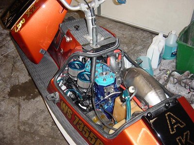

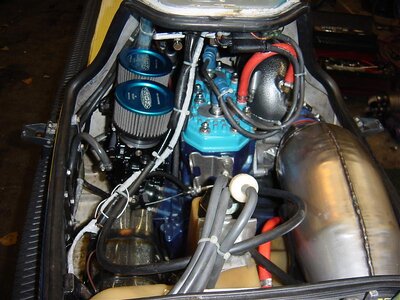

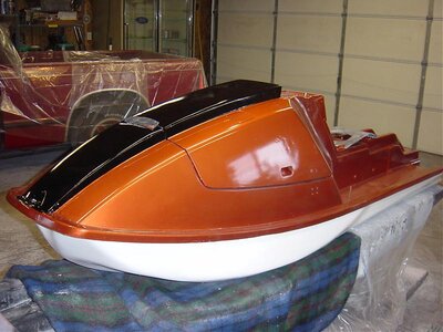

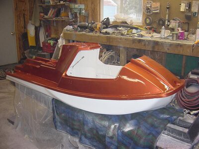

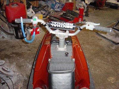

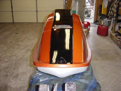

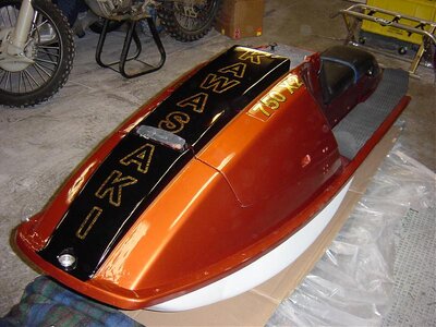

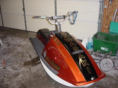

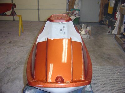

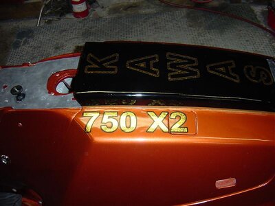

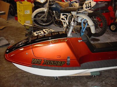

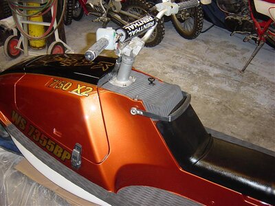

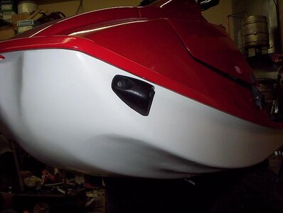

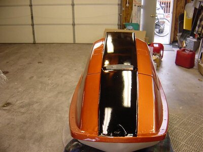

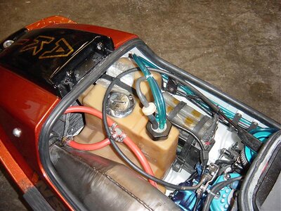

here is the progress It has taken 3 weeks of hard work but the end of sucking paint fumes is near...I filled the nose cut the rear ...tubbie II's installed cut and filled the fuel door shaved the hood...engine will be big pin bottom end with small pin ported cylinder...sxr carbs and factory blaster limited pipe...750 electrics...sxr prop
