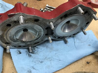

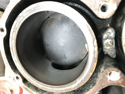

Just picked up a 94 blaster with Riva red head, Riva Red pipe, impeller, intake, ignition rev limiter upgrade, etc.... Compression on rear cylinder was 155 but front cylinder was 130~. Pulled the motor, popped the head off, and definitely a blown head gasket. Cylinders look decent with no marks/scarring of any nature BUT also no hash marks from a hone. Its probably been a while since it was freshened up and I have no idea on history. Should I take it in and have a machinist order some pistons to match and hone it, or just order new head gasket and put it back together?
