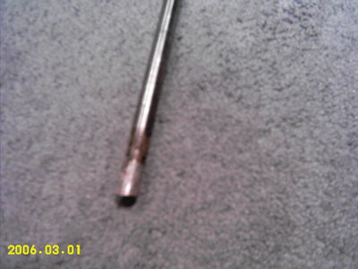

I went and took the blades off first to get them out of the way. Then I went to work on the body of the impeller - remember there is actually 2 sections to the body, the outer "cone" and the inner (and much thicker) part that is actually threaded onto the driveshaft.
When I got done, I found the driveshaft to be galled on two consecutive threads. That was not acceptable for me to try to put another brand new prop on it. I also found that I had slightly nicked the stator vein, but it was just under the impeller and not being a moving part wasn't a problem.
I ended up buying another good driveshaft and impeller, and used the old stator vein.

As regards the old driveshaft - I'm keeping my eye open for a really low-pitch prop in used but decent condition to just put on the shaft for the last time - I'd like to have a arm-yanker pump to play with when I want it.
Or, I am also thinking about cutting it off and making a intermediate shaft tool with it.
