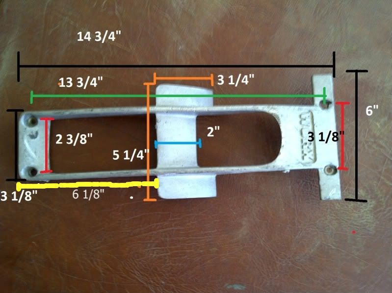

SX/SXi/SXi Pro Need measurement of Kawi 750 scoop grate
As titile says.....I'm looking for a measurement of a 750 scoop grate. I'd like total length and width, and distance between holes, if possible.
Help!
Thanks in advance!
the bolt holes are measured from the center, i hope these were the ones you were looking for?... if not lmk its sitting here on my desk.
