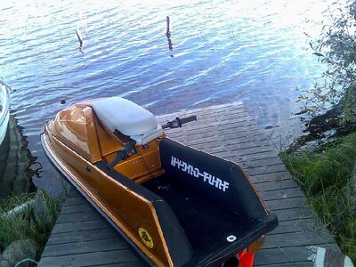

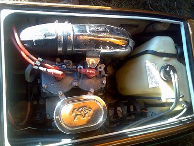

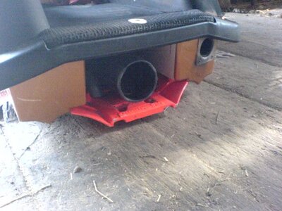

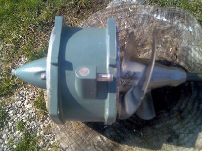

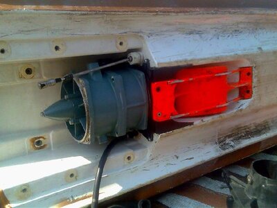

Hi there, just wonder if the scoop Jet dynamics (on pic) is anything to keep or should i buy another one, i mainly ride lakes, freestyle... and i also have a Quadrafin rideplate, anyone have some info on these stuff? and, the protec pipe on the pic, anything to keep or should i upgrade? the engine is a 650.
And the Skat-trak 9-17, any good for freestyle?
Thanks in advance, could be fun to hear if this is good or bad stuff........
/S

I would keep the scoop. I would remove parallel running 1/4 in bars . That was for the old scoop ruling. Ditch the impeller and go with a freeride skat trak impeller. If the engine is a 650 keep the pipe and port the cylinder if it has not been done yet ,thats what is holding you back not the pipe.

So you mean that the 2 bars parralell with ski on the scoop are just som safety, rule thingy that can, and should be removed? i will remove the cyl and have a look, any specific port "style" i.e sport-port, race-port. seen some templates.... you recommend?
