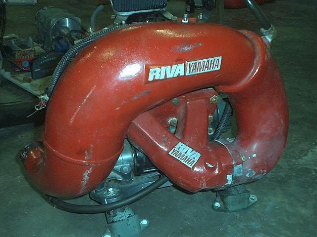

so - It's a stock 61x, with a Mikuni 44mm carb, Ocean Pro flame arrestor, 6m6 electronics, and a Riva pipe (similar to this one: http://i268.photobucket.com/albums/jj39/shift1313/Jet Ski/Jul27_02.jpg except the exhaust outlet is toward the front of the ski)

Here is the jetting I had in my old SN with the same Riva pipe:
145 main (1 1/2 turn out)
120 pilot (1 1/4 turn out)
95 gm spring
2.3 n/s

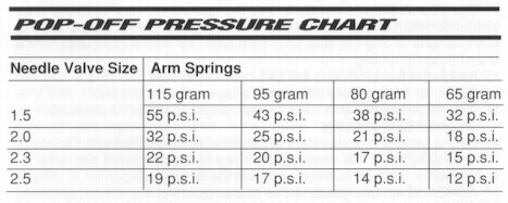

Springs:
65 gm: Shiny silver
85 gm: Black
95 gm: Dull silver
115 gm: Gold
#ZERO
Beach Bum
Florida - U.S.A.
If you pull the seat out it has a small number stamped on the bottom and the pilot jets are stamped on the side.
You can check the pop-off pressure with a tester and compare it with the chart below if you're uncertain about the spring color.
