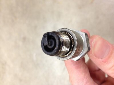

I'm running the BR8HS plugs and I just pulled them after yesterday's ride and they look very rich. I pulled them before yesterday's ride and they looked brown. Anyway it could have richened up on me without me adjusting anything?
I threw some new plugs in today and it ran great with no hesitation until I overheated the motor and the sensor shut me down. I located the problem (cooling line became disconnected) and fixed it and rode again and the hesitation was back again. Plugs still look new
