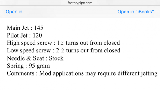

Looks like you have it jetted per FP specs if your needle and seat is stock as well (1.5). Turn the screws out per FP specs and go from there. These specs are close to spot on for your setup.
Low: 2 1/2
High: 1 1/2
Ok cause I went to 2 1/4 on the low and it would hardly get out of its own way, the more I turned it in the better it got, just not sure if I can go lest than 3/4 or if I should start looking for a different problem

If it gets better as you go in then you're rich. You can go in less than 3/4. Just make sure you don't do anything crazy like WOT and such right away when making adjustments. Best to play it safe. What's your elevation?
