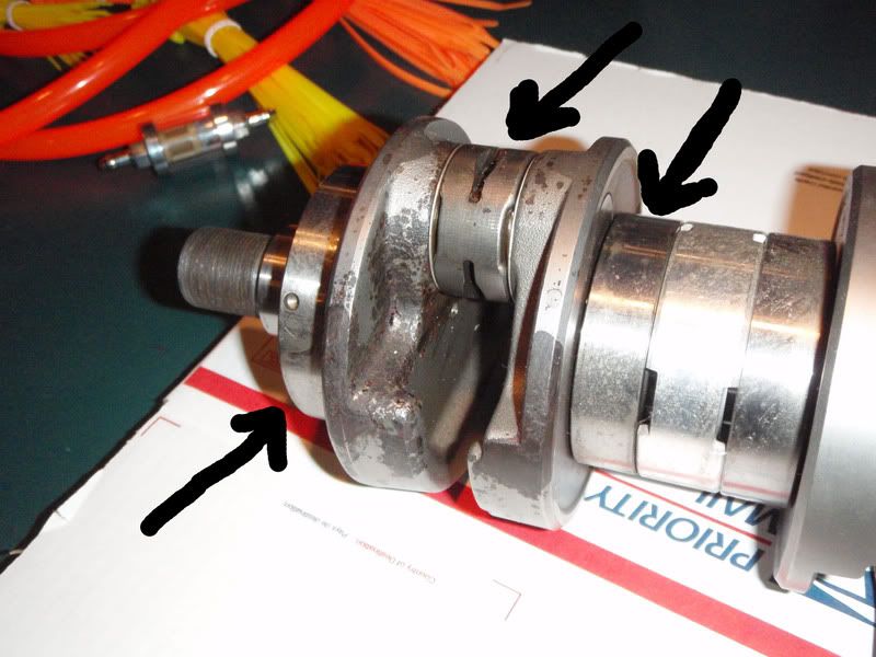

This crank was said to be new last year ,forgot to winterize and it got a little rust on it. The rod bearing is a little sloppy with a hint of grinding and the 2 other bearings seem rough also,see pic. What are my options,can this be fixed? How much? Should i just look for a different crank? Thanks for any help.

If any bearing is in question you need to have it replaced, you can either rebuild the crank or purchase a new or rebuilt crank you will have to weigh the difference.

Not being winterised won't make it sloppy by itself. If you feel any grinding it will need new bearings or a rod kit.
