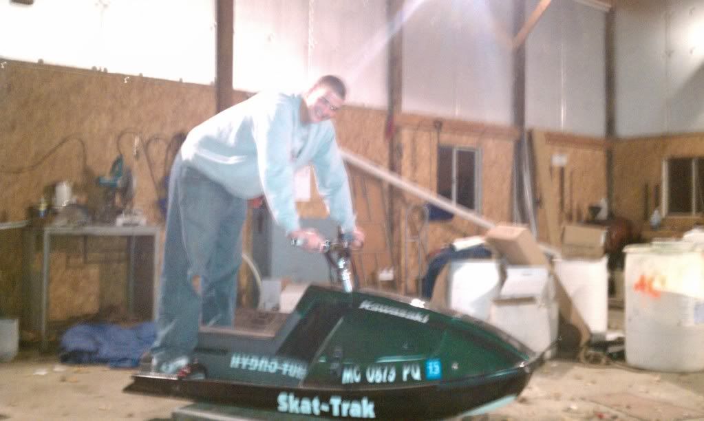

Heres the ski.
My best friend is 6'9 too but he weighed about 270 in this picture. Just for reference what you would look like riding an x2.

That is hilarious^ he doesn't look like he would be comfortable riding that x2. Back problems after the 1st ride.

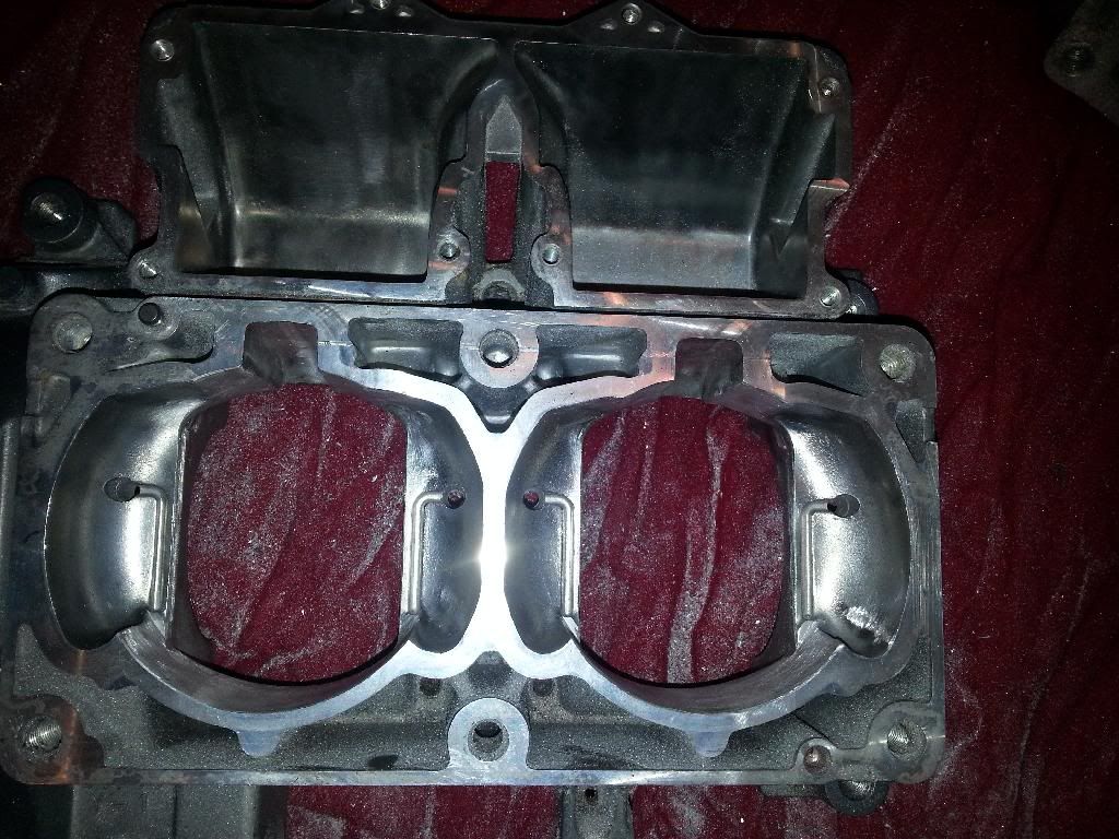

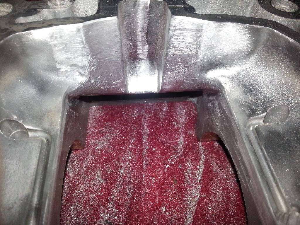

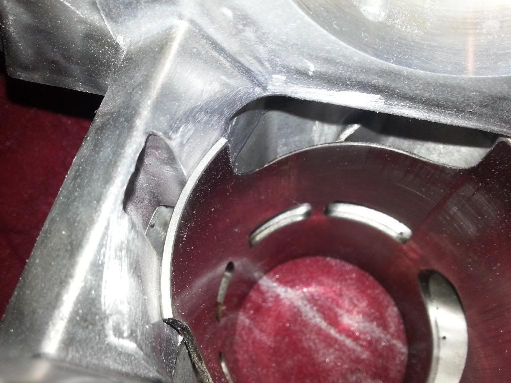

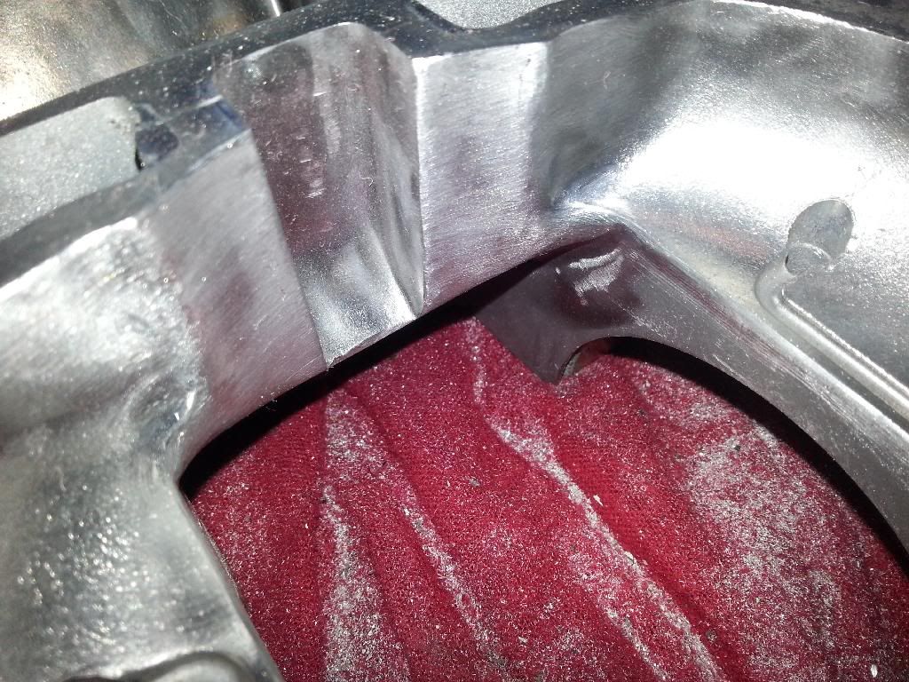

went and bought a flywheel puller (on sale) and a dremel kit. got the case done to my liking. next is to bore the exhaust to match the cylinders. its a pretty close match already. should start building next week, maybe even this weekend.
CRJ
Hibernating
Toronto
One exhaust port done, one to do tomorrow. should have most of the fitting work done by tomorrow night.
