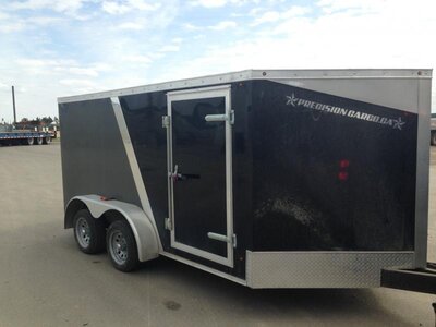

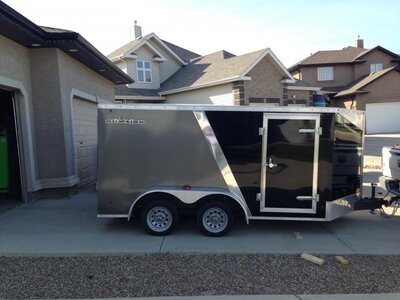

So I got sick of transporting my skis on an open standard pwc trailer so I ordered a custom built 12ft x 7ft enclosed. I had it built so I can drive it through my drive through garage bay and park behind the house with all my spare parts inside, that is why it is an oddball height of only 6ft10 (my stupid house was built with all 8ft doors on the front of it and then 1 7ft door on the back.....stupid!!!!). I just started on this trailer yesterday and its no where near complete but here it is.

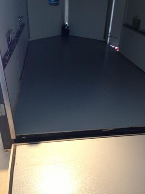

IMG_0865.jpgFresh after epoxying the floor with some silver

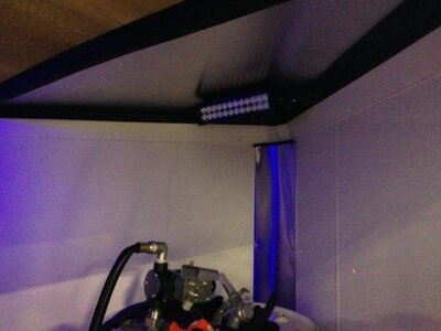

IMG_0886.jpgJust a quick test fit still have lots of work to do. I put a drum of c12 up front with a 12v fuel transfer pump to make refueling quick and easy.

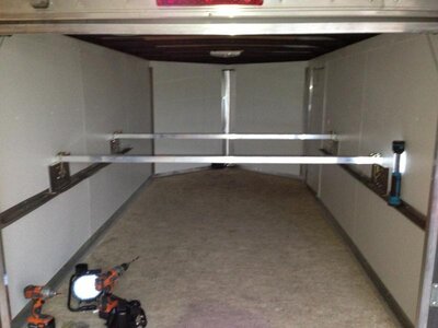

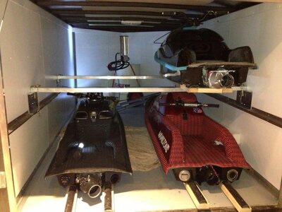

I am currently building a rack with rubber castors that will roll the skis on effortless for my wife and her sister. I will post more pics this weekend.

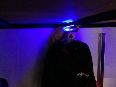

image.jpgLED wetsuit rack

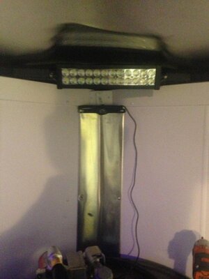

image.jpgLED lightbar. It was a little brighter then I intended but works good. I'm putting a few 40" bars on the outside too.
image.jpgLooks like a junk yard give me another week. Got the racks basically done.

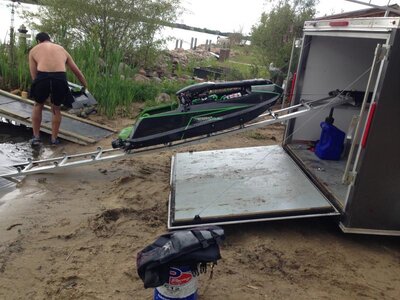

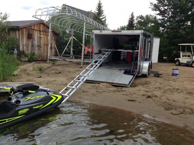

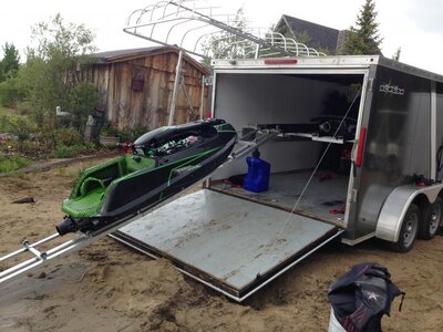

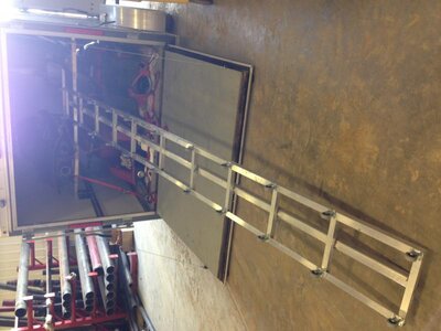

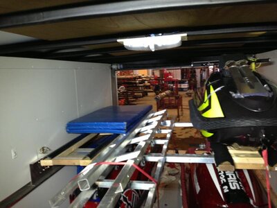

image.jpgThe 14ft alluminum roller rack splits into 2-7ft racks that will hang up on the wall inside. I intend to mount a winch to pull the skis up but this is extremely easy as it is. This is just a prototype that I made up in a few hours. It's not done yet I still have to figure a bracket to place from the ramp to the racks

I changed the top bunks from wood to alluminum. They have half of a 6ft x 2.5" abs pipe And marine grade carpet on top. Slides awesome and no scratches. The roller ramp works amazing now too finally finished. Enjoy the pics

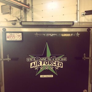

Also mounted a 41.5" LED light bar on the back so we can light up the lake for some evening riding. I still have to mount the Clearance light back on just underneath it.
