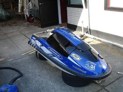

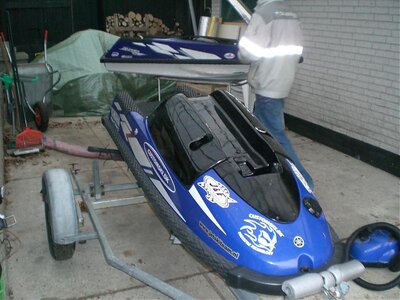

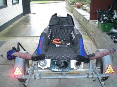

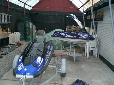

I decided to make a thread as this project is beginning to grow.
First i just wanted a superjet with footholds, and a pipe.
Now its beginning to grow, so far i got.
Nujet 5,0 impeller
jet dynamics grate (i think)
UMI bars
ATP footholds
Hydroturf freestyle matset
ATP scupper valve
rule 500 auto bilge
glas/carbon freestyle hood
carbon nose piece
factory b mod pipe
MSD enhancer ignition
ADA head (just sent from wfrider :))
yestoday i epoxied my bondline, and today i reinforced the sides with carbon.
i going to do the bottom and handlepole area tomorrow if theres enough expoy heheh
some pics
more to come!

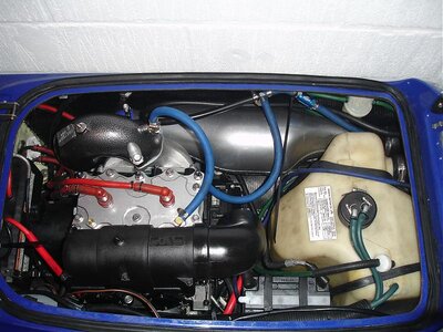

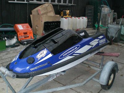

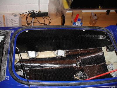

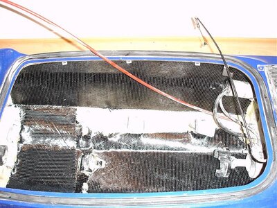

got reinforced the sides, the bottom, the handlepole area and the hood hatch area (or what its called) all with 2 layers (crosed) 400gram biaxel carbon fiber and west systems epoxy.
Peace out for now

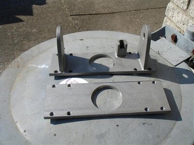

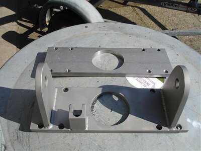

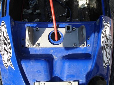

Got my custom made lowered pole bracket
Got my custom made lowered pole bracket and mounted it.
8mm acid proff SS. tough bad boy hehe.
What do you think ?
