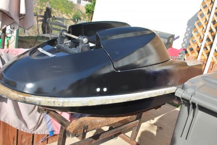

Super Jet my first superjet

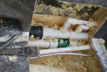

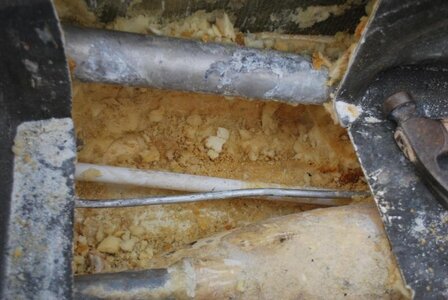

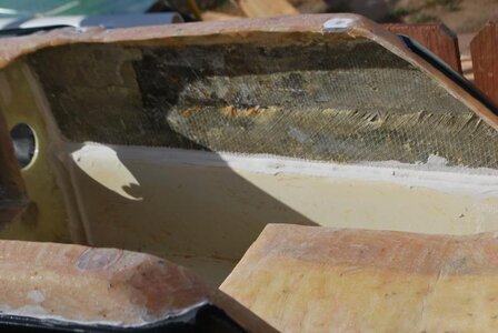

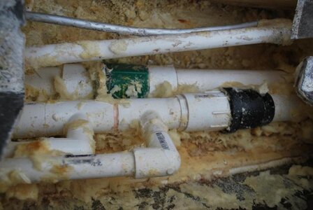

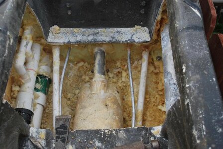

Well I expected to do some work on it when i bought it but man this thing was someone's hack job! The more I dig into this thing the more i find that's messed up. the list goes on and on. My latest findings . about 30 LBS or water in the foam along with a landscapers pvc sprinkler system haha

Jeremiah does that thing have lawn sprinklers in the tray ? maybe astro turf instead of hydroturf ,idk ,Lol><gnarly plumbing> .. do the bob footholds and chop that bi#$% a couple of inches shorter while your into it
they decided being in the water just wasn't enough to cool them off . haha They were to lazy to get off the ski and jump into the water so they made a sprinkler system to keep cool without getting off the ski ! I should start making those , haha anybody want one? That's a good way to get rich but I'm not gonna throw all my chip at it just yet

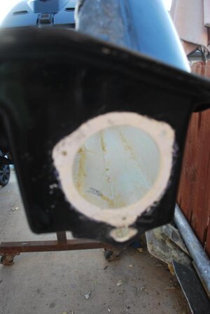

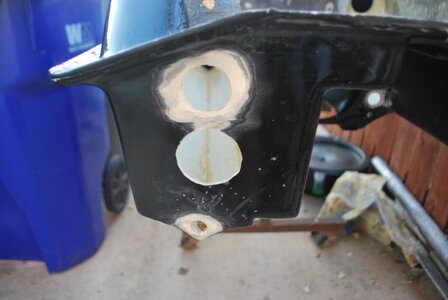

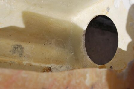

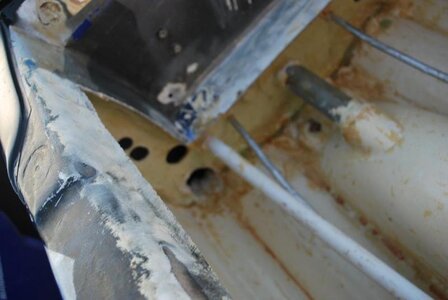

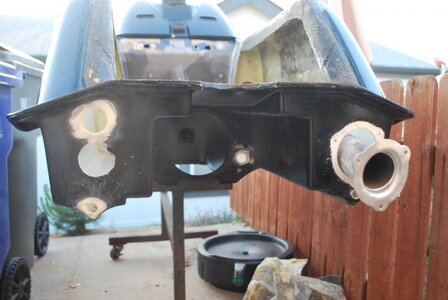

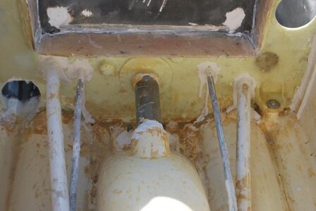

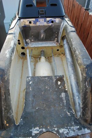

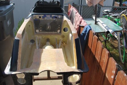

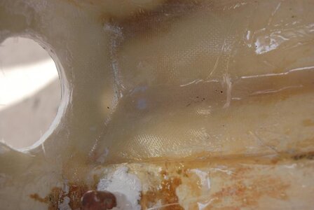

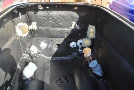

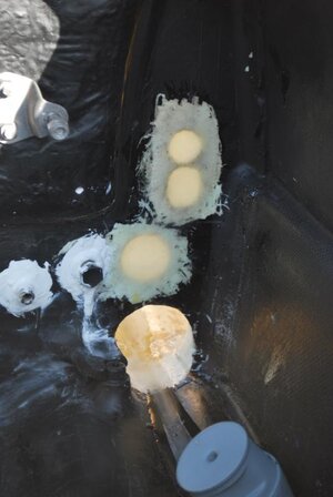

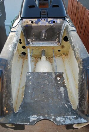

not a lot of progress this week but i did do some stuff! cut out all the old sealant everywhere in the trey and "totally" re-sealed everything! cooling lines trim cable tube ,my ghetto rigged steering tube , the bond line and all bolts. glassed in the drainage holes and all the wholes that were from the old sprinkler system haha. widened my trey a few inches and ground down all around to raw material . almost ready to foam and glass the trey .
