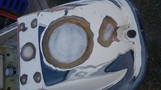

I recently purchased a 1994 FX1 which was bone stock aside from a b-pipe and msd ignition. I rode it once and it wasn't that great compared to my old 2008 SJ. So it's time to completely strip it down and build it to what it needs to be.
My list so far is:
RRP billet handpole w/ OVP steering
RRP trim system
RRP adjustable footholds
Tom21 tubbies
Tom21 144 pump tunnel
Reinforce the entire ski
Possibly shorten the gunwale
Rocker the rear
So far I haven't been disappointed. I pulled the turf off only to find someone had drilled a bunch of holes for what seems to be surface mounted footholds. No epoxy was used, just drywall anchors that fall into the foam when you try to thread a screw in them. Good thing I was planning on removing the foam anyways...
