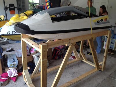

Super Jet My 90 sj will cut out after awhile. Temp gauge?
I will run it and take it on a few laps try some freestyle and that's all it takes. The engine will cut out and if I start it it will run momentarily and then quit. Let it sit it will run for maybe 15 sec. It gets hot more than it used to I never had this problem until I let my friends ride it. But I think it's the temp gauge. Hat some gunk coming out cleaned it and I haven't tested it yet hope it works

Sorry about the the chatty post I was in a hurry and my iPad was acting up. Well it's not steaming I tried putting water on it to cool it off. No sizzle. Tbh I don't know what I'm looking at its my first ski. Could be the filters the fuel tank has epoxy in it from putting a fill neck in the tank. Well it was some yellowish stuff. I cleaned it put some grease on it put it back in. What lines should I check? I have a spare cdi box that's not what could be causing it right? I'll try and check them.
How can I tell? When it cuts out I can start it for a few seconds then it cuts out. Let it sit runs a bit longer. Then if I just leave it alone for an hour it's fine until it runs for maybe 10 15 min. I'm finally getting the title for it today hopefully so I'll take it out and have more detail on what it's doin when I come back
